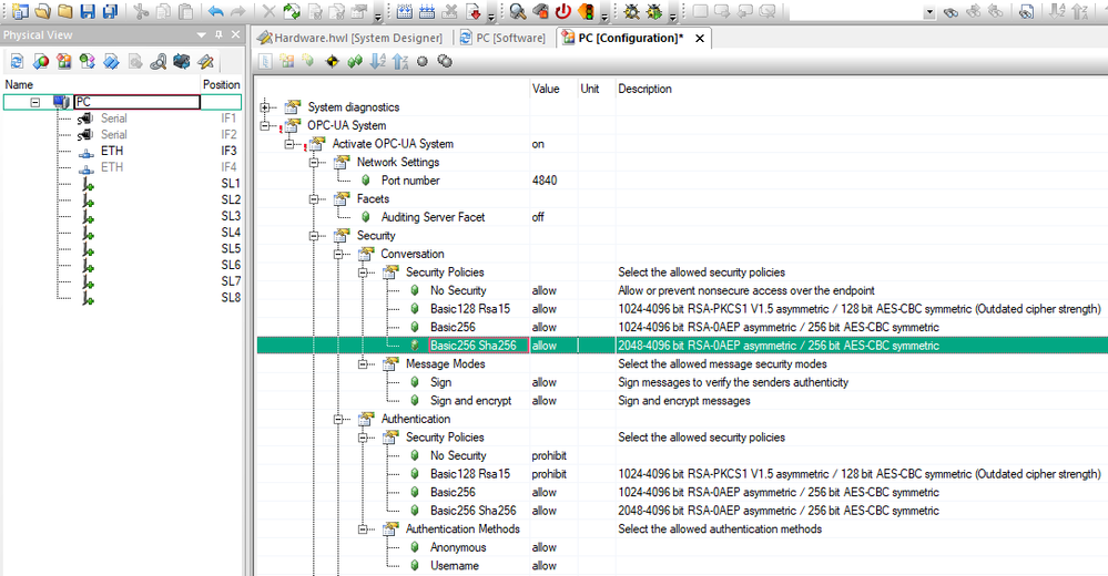

Yes, I just built open62541 from sources and then tested examples (simple Server/Client) together with NI OPC US (using NI OPC UA Server with open62541 client and visa versa). It works (as expected). I also compiled open62541 as stand alone DLL for dynamic link as suggested by Rolf and created simple wrapper (using NI CVI) with just Connect/Disconnect functions. Last weekend I installed latest B&R Automation Studio (because here is my "reference OPC UA Server as long as we using B&R PLCs) and checked which security policies are supported here:
But I didn't check yet Sha256, this is my plan for next weekend if time permit. After that I'll share everything (currently its too early, because I have the only two SubVIs - Connect and Disconnect).
