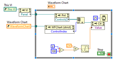

Message 8 of 18
(2,805 Views)

@Florian.Ludwig wrote:
The vis can be found in Programming -> Application control.
Basically you can set/get value not by the reference to the element, but by a reference to the owning vi and an index number corresponding to the element. It is a much faster read/write (which may not be relevant). You cannot manipulate other properties that way though.
Is this globally what you are suggesting?
If yes, how is it different/faster than this (what I am pretty much doing currently).
Message 10 of 18
