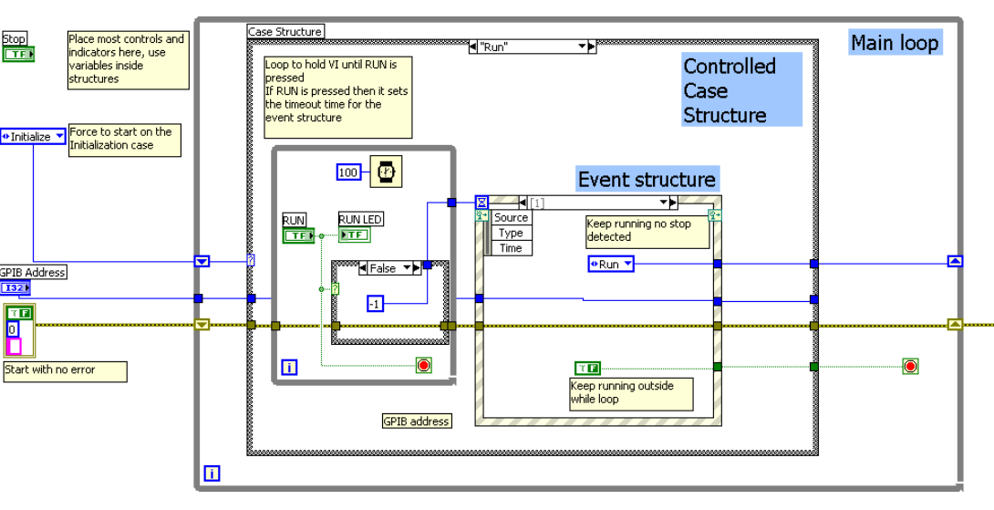

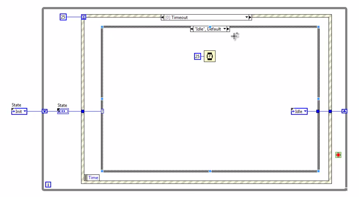

I found myself in a crossroad.
I have three different ways I can implement my code, but I don't know which can be better for my purpose.
I have a sequential program, where 2 parallel processes runs, at certain moment, one process have to wait each other to continue.
Which of these structures could be better?
1)controlling the processes and user button with a queue handling event?event-Message_Handling.png
3) having diffente cases inside a event structure (where all is in the default event, but for others send them to the different cases)EventDrivenState.png
and in all of the cases, should I use the value (signal) element to trigger my processes from events?

Just to add:
I have 4 events:
2 triggered by UI (start and Stop) and 2 triggered by reg event callback ( motor process and laser process).

@dkfire wrote:
The Event structure should be inside the case structure.
Disable and enable buttons is "just" part of your code, there are not specific examples for that.
I read that creating an event structure inside a case structure should be avoided.
http://zone.ni.com/reference/en-XX/help/371361K-01/lvhowto/event_struct_outside_loop/
Message 44 of 60
(2,750 Views)
Yes there is canvas on having the Event Structure inside a case structure in a while loop.
But if you design correct and you do not use the "Lock Front panel" option on events, then you can have the Event structure in a case.
But I would go for your option 1.
