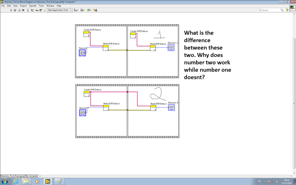

I have created a simple write and read numeric value project with these functions in 2 vis which is in one class. Now the object of this class has a DVR of a numeric value. Then I created the create DVR vi which creates the DVR. Then in the main program, I branched the create DVR to both Write and Read VI. Then when I ran it, it worked fine. The value that was written into write was read from the read vi. Now instead of branching I made a copy of the create DVR and gave the first Create DVR to write and the second to the read. But then it doesn't work: Can anyone please explain me what is the difference here.I think I know. I believe while branching I just create DVR data and giving it to many, but while I am making a copy, then I am creating two different references. I think this is the reason. If this is the reason, what can be done to achieve my second operation, because in my project, the write and read are not used in the same VI. I need to write at one VI and read in multiple VIs. So how can I achieve that.DVR Data Problem 2.png

Did you read the proveious messages before trying to create a new thread for the same topic?
Use a wire and connector panes to forward the class object.
THINK DATAFLOW!

yes I read the previous messages and then I tried it on my own. I found out my previous mistake was I was not creating the dvr object. I found out I have to create dvr object and pass it to my method vis which uses that reference. But what I didnt know is I cannot copy the dvr create vi which will create two dvrs instead of reference one dvr at multiple locations.
