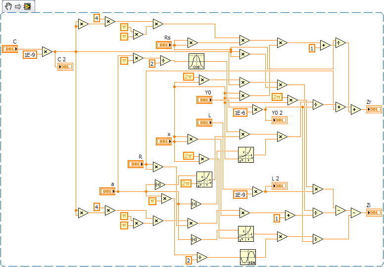

In case you were wondering what your FN would look like in G, here it is.  This helped me spot a small error in my code which I have fixed for the beta version.  Of course, if I were doing this in G I wouldn't separate the real and imaginary parts.
Message 16 of 44

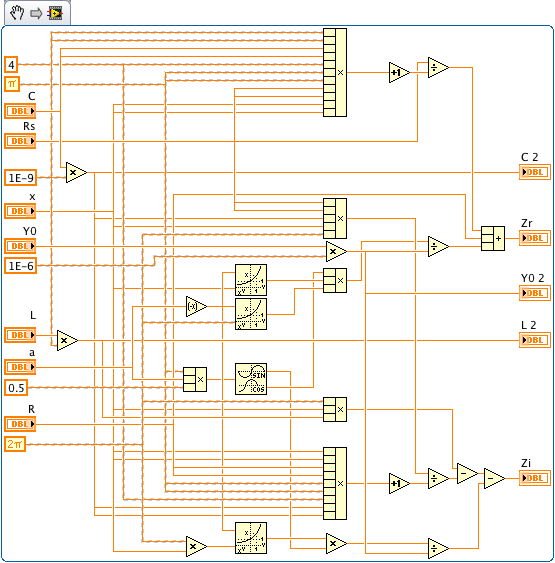

Darin.K,
You calculate the  same value multiple times (C2*C2 for example) and repeat constants (pi). Compound arithmetic, Increment, and Sin & Cosine can help simplify it further.  I ran this and it show the same values for the defaults as yours, but it may contain mistakes.  I did not check it closely.
Lynn

That was automatically generated by copying and pasting the formula from the FN into my VI.  My parser is pretty good, but not that good yet...
Message Edited by Darin.K on 11-06-2009 03:36 PM
