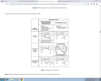

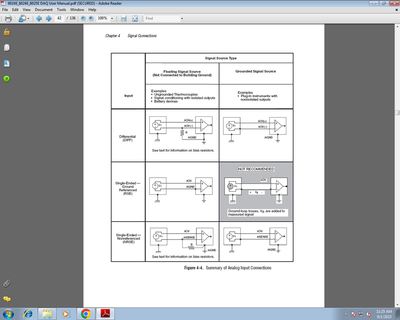

another thing i noticed was that in this link
https://www.ni.com/en/support/documentation/supplemental/06/field-wiring-and-noise-considerations-fo...
the wiring diagrams were mentioned in table 1 as
Notice DIFF and NRSE config in floating devices,
whereas in the manual for my device NI PCI 6024E the wiring diagrams were
which one should i follow?
but, when i follow any of these wiring diagrams i cant read the signal in DIFF and NRSE mode while using 15K ohm resisters. i dont know the impedance of my function generator.
Message 7 of 8
(1,915 Views)
