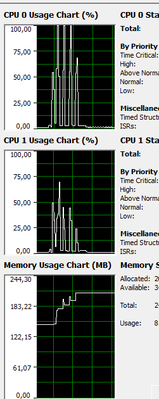

first of all thank you for those great examples. They were easy to understand. When I tried sending different types of data it worked great but once I implemented image aquisition from my vi it didn´t go so well. When I first ran the application connection was established and images were streamed but in a way that timed out indicator was switching state constantly while image was switching with empty one and then Myrio disconnected after around 20 s.  When I ran it for a second time there was image stuck in a writer side and nothing on reader but timed out was flickering. I opened Distributed system manager so I could check memory and my usage was quite high.
Don´t know if I did something wrong. But maybe its my webcam that it cant keep up. I have generic usb 3.0 1080p camera that is configured in MAX to acquire video in 480p 30fps.  I just noticed that it displays fps at the bottom of MAX, but shouldn´t it say 30 fps acquired  or more of displayed?  I´ve seen displayed be at 5 when using grab in MAX.
EDIT: I freed up some memory and it runs better but timed out indicator still flickers while its receiving image. Cpu usage now is around 50% and memory usage continues to rise from 130 MB to  205 MB as shown in the image up.

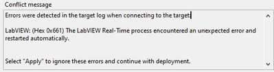

And after connecting to MyRio again after it lost connection theres this error. Which after diging trough forum seems to indicate memory leak.

Hi Jenda,
I could share all that I knew about NS so my knowledge stops here. As NS works with other data types. I think it has to do something with data acquisition VIs and it's data type. Your CPU usage is at 100% no wonder why your myRIO is resetting.
I have no clue about how image acquisition works. But if I had to take a guess:
1) Either a lot data is building up fast
2) Some loop is running without enough wait (Longer the wait lesser load on CPU)
See if the follow makes any difference:
1) Start with 5 second wait time in RT VI and bring it down gradually. See if that lowers your resource consumption.

I tried it with 5s wait and each spike to 100% on CPU0 is one frame sent. Memory started to build up fast and last spike to around 50% is when Myrio was disconnected. So my guess is that the first point is right and Rio cant keep up with data build up so it disconnects.
EDIT: What did you do to bring down CPU usage and how did you free up the memory?
Last image was right after restart of MyRio and I deleted deployed RTstartup from the unit and it freed up the memory to around 130 MB.
