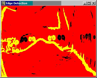

I have attached the (Lv2014) VI that I used for my quick experiments. It is all very empirical and manually tweaked for that particular image, so likely far from ideal processing but I hope you can use it for inspiration. I also tried smoothing based on frequency domain truncation but did not achieve significant improvements.
I originally tried to avoid operations like dilatation as it can be difficult to control. While it may join broken edges, it can also create connections that are definitely not intended. It's always better to pre-process the image as much as possible before resorting to morphology tools. Here is the result of the processing using the attached VI default paramters (yellow color fill added manually to check continuity).
