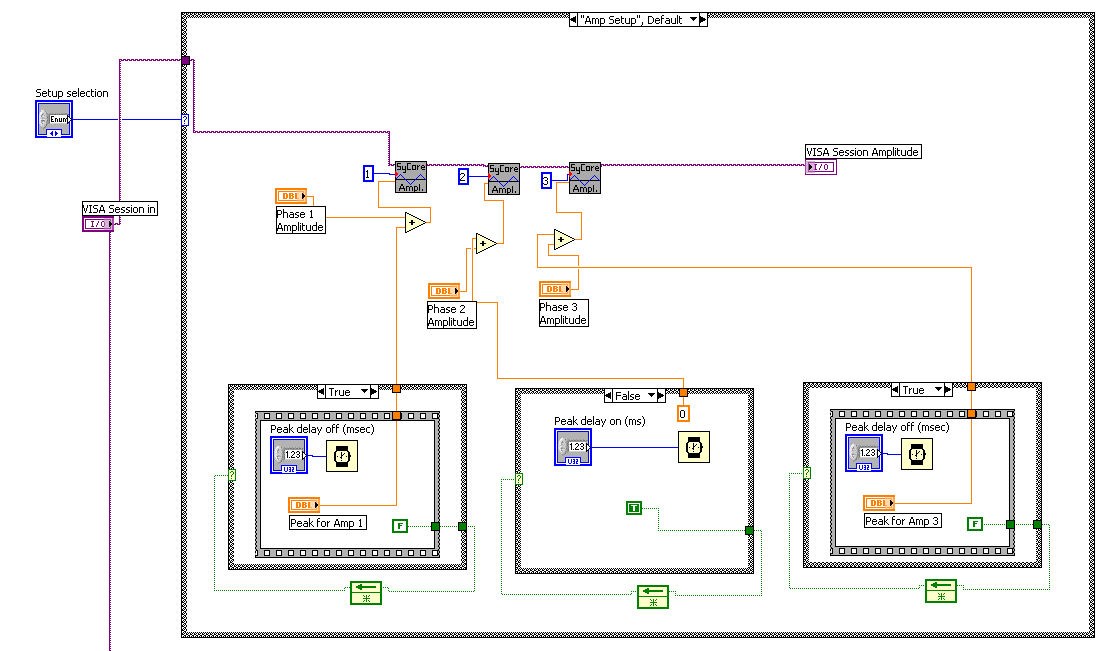

In the attached image there is a vi that i made to control the amplifier.
I give amplitude DBL value to the Amplifier like 50V or 60V and it is there on amplifier.
They problem is that I need to control the amplitude with the timing. Like i want 50V continious for 5 sec and then a sudden peak of 100V for like 1sec or 1msec and so on.
What should i do?
Any help...!!!!!!

Something like this could work.
The two Array contain your wished cycle data.
Voltage
050V
1100V
2xx V
etc.
Time
05000 ms
11000 ms
2xx ms
etc.
So you can build your cycle.
It's not a sophisticated solution but easy and quick.

Thanks adigator
I find out the solution and now I got what I was thinking...

I really think you should go with adigator's solution.  You can just pass in the arrays and call it a day.  It's a lot simpler to figure out as well.
