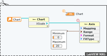

You probably did not see that XScale is a reference, which is indeed read-only. Just do this:
(3,098 Views)
I'm still looking for a way to mimic the multiplier property node from regular LabVIEW to modify the numbers on the x-axis
