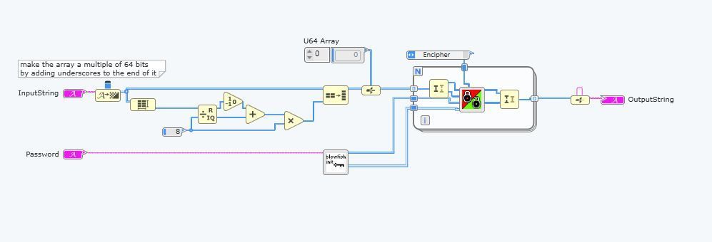

Hello , I have created a NXG 2.1 project of blowfish algorithm which takes in 2 inputs which are "username" and "some key" in order to generate an encrypted password (Output String).Check image below.
Now the code displayed below is of labview 2017 which is identical to above code of labview nxg
If you see the output on labview front panel in the above image , it is "\1A\14v\88\FCe\CC\8F "
but on labview NXG 2.1 the output is totally different.Check image below.
(The inputs i have provided in both cases are the same).
I am not able to understand the reason for this different outputs.
Can someone help me out with this.
Thanks for taking out time and reading.

If you probe the wires of each when you run the code, where do they differ?
I know the string handling in NXG has changed to support UTF-8, so there are some changes in the string VIs. This may be one reason for the difference you're seeing.
