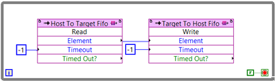

I'm using NIFPGA Python library to communicate with FPGA. I can open a session, write to controls and read indicators on the front panel, but when I set up a FIFO and try to use the FIFO from Python, each time I try it, Windows freezes down completely - it doesn't react to mouse movements or keys - and it needs to be powered off and on again. Below is a screenshot of the minimal test VI that i'm using; it is essentially the example from the Python library documentation (here), consisting of a Host to Target FIFO and a Target to Host FIFO, connected to each other.
The Python script that I'm using to access the FIFO is also the example from the library's documentation (here). Both the test VI and the test Python script are included in the attached zip file, as well as the minimal test project I'm using, which includes the FIFOs. I created the FIFOs by selecting New->FIFO in the project explorer - I changed the type to "Host to Target - DMA" for Host to Target Fifo, and "Target to Host - DMA" for Target to Host Fifo, otherwise I kept the default settings.

Newer versions of Windows have thunderbolt DMA security features that might not be playing nice with the R Series card.  You might google around some and check if you machine has them enabled and see if disabling them changes the behavior at all.  Usually if you are running into those though your machine will blue screen rather than just freeze.

Thanks, that seems to be the case indeed: I was able to try it on another computer, which did not have kernel DMA protection enabled, and it worked fine. Now I'll just need to figure out how to disable it on my primary computer. (For the record: When I tried several times on the computer with the kernel DMA protection enabled, most of the times it freezed completely, but once it gave me a blue screen. Therefore, it seems that either behavior can occur.)
