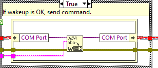

I made a simple VI, that will communicate with a device on each serial port, just to try to get it down to its "simplest" form.
When looking at the execution times of the commands, I would expect them to be similar in times (under 2 seconds for each serial port), but I am seeing that is appears that only 2 of the serial ports can communicate at the same time.
Notice how two of the devices are under 2 sec, and the other 2 take considerably longer.
All of the VIs are set to Shared Clone.   Some of the VIs internally are Pre-allocated subroutines, but otherwise are Shared Clones.

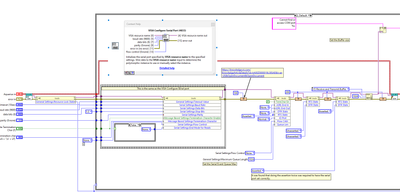

- I have tried running the Read/Writes as both Asynchronous and Synchronous, I didnt notice any difference.
- I have run the VI Analyzer to check for re-entrant issues, and found none.
- I tried adding in the In Place element structure where there was an unblundle/bundle (per VI analyzer recommendation)
- I have the high resolution relative seconds sprinkled around to gather some timing stats.  It is a Pre-allocated subroutine, but I wrap it in a Flat sequence structure to control data flow.
- Replaced the VISA Configure Serial Port with the actual code on the block diagram, since that VI is not re-entrant

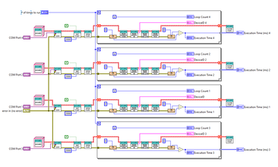

Ok, an update.  When using the simple VI, if I move each serial port into its own FOR loop, I can achieve the expected parallel performance
Times are much faster, and way more consistent.
I also did create a quick and dirty Cloneable DQMH module, and the times are still matching the parallel FOR loop in the code above.
So that means that the issue is in my actual test code (which is a lot more complicated than the simple module shown here.
I guess ill keep trying figure out what is causing the loops to not do the communication in parallel.
