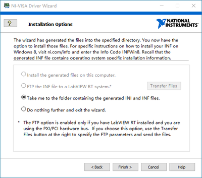

NI-VISA Driver Wizard trouble
NI-VISA Driver Wizard(Installation Options)cannot choose “Install the generated files on this computer”.
0 積分
1 條訊息(共 2 條)
1,969 檢視
Did you try to refer to this link to sign an INF file which had been generated by the Driver Development Wizard to the specify directory:
https://knowledge.ni.com/KnowledgeArticleDetails?id=kA00Z0000019L9QSAU&l=en-MY
If you having trouble on how to find the Inf2Cat tool,
Try to find it in your pc under
Program Files>> Windows Kits>> 8.0/10.0>> bin>> x86
or
Program Files (x86) >> Windows Kits>> 8.0/10.0>> bin>> x86
or
Download the tool from the 1st link and refer 2nd link if you need tutorial on how to download it:
https://go.microsoft.com/fwlink/?linkid=2128854
https://learn.adafruit.com/how-to-sign-windows-drivers-installer/installing-windows-sdk
After finished download, using the same file path to file your Inf2Cat tool.
Thank you.
