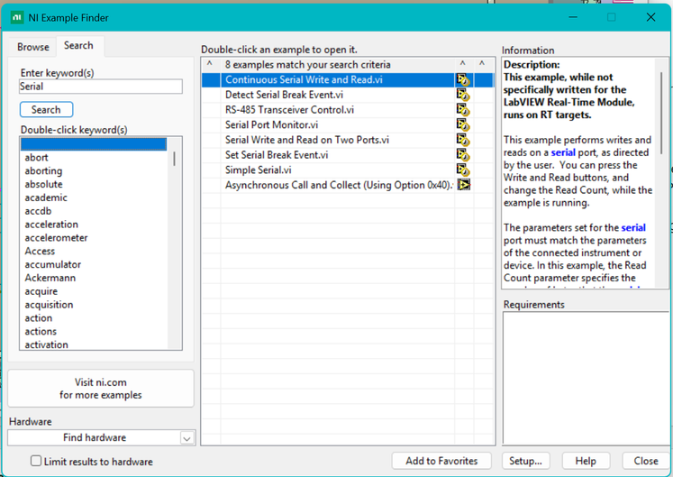

Hello Jay,
Yes, I already have the USB to RS485 but now the problem is USB Hub on which I will connect all USB to RS485. I don't have other devices and USB Hub to connect therefore I'm confused the USB cable coming out of Hub will show me one single COM Port on VISA or it'll show me Multiple COM Ports?

Hi Smith,
The hub works as "multiplier" to the number of available USB ports (transparent to your application).
You will see as many COM ports as you connect USB-2-RS485 converters to those USB ports…

Hello Gerd,
Thank you for your answer. Do you have any example to start with?
Message 14 of 15
(552 Views)
Hello Gerd,
For examples start here: in LabVIEW navigate to Help/Find Examples, then search Serial
