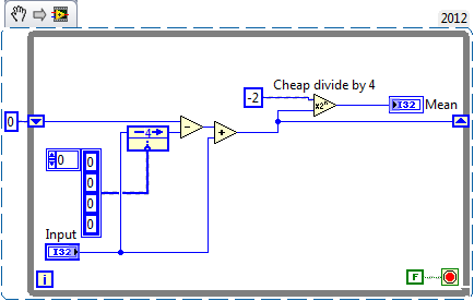

This is what I would do.  I am old fashioned and do not like using floating point on an FPGA, way too expensive.  This is for integer math; it will also work with fixed point inputs.
Using the 4 sample delay will impart some error on the first 4 mean samples, but will be fine after that.  This assumes you don't need the history data as was previously posted.

WillD wrote:
Of course.  I forgot the feedback node had that delay feature to it.  I was trying to come up with something similar with the subtract oldest value and adding new value before dividing, just couldn't quite get there with the shift register holding the array.  And by that point I figured I might as well just keep with the simple average.

You can get the same effect by click-drag-expanding the shift registers on the left side of a loop:
