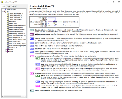

Hi, I'm doing my first project with Labview. I need a simple example in which the Labview project is the slave of the Modbus RTU communication. My custom board is the master. Thank you.

It is a TCP example. I changed from New TCP Slave to New Serial Slave and completed the connections to this block. Are there other modifications that I need to do? Thanks

Accepted by topic author V.Life
In the slave example, just replace 'Create TCP Slave' by 'Create Serial Slave' in the polymorphic selector.
You have now to set a few Serial options.
 Don't forget Unit ID (Serial adress).

Thanks. That's what I already did. The scope of the Slave RTU for my project is to receive write register command from the Master (and then save data on the Slave) and receive read register command from the Master (and then the Slave has to transmit to the Master the response message with the requested data). So many of the elements in the front panel are not necessary now.
When I execute the program I get the error 56 @RTU Data Unit.lvclass: Read ADU Packet.vi 5030001

I solved by making a new project from zero. Thanks
