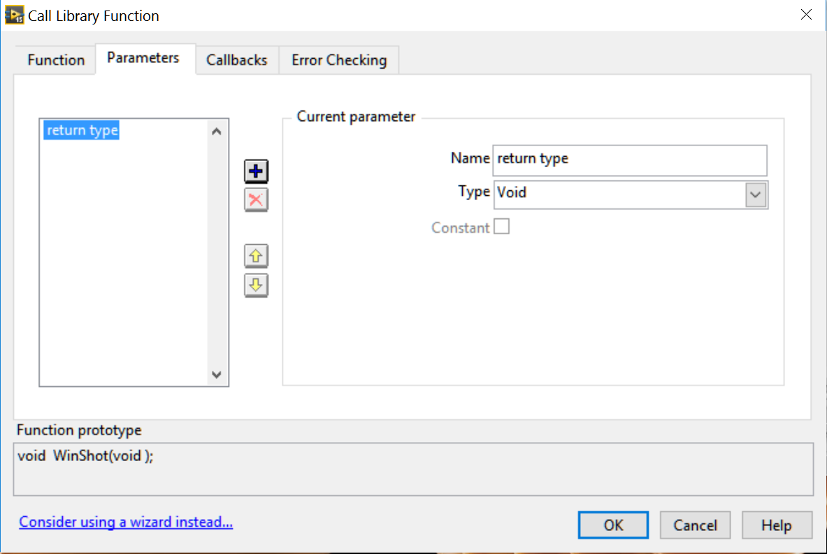

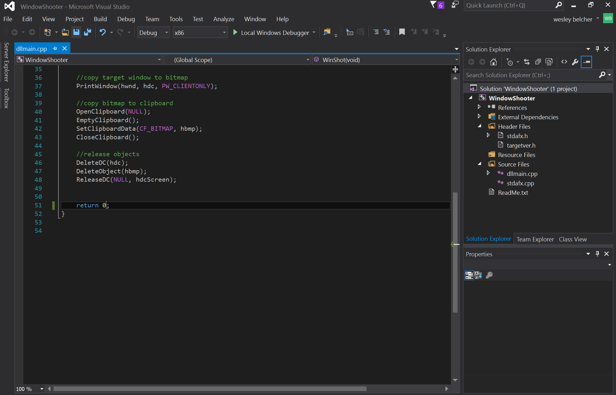

After fiddling with my previous attempts at calling a custom DLL I have had some success. It appears I had some function parameters round the wrong way and some others of the wrong type. My DLL function borrows heavily from the example C++ code posted in the solution of this forum thread:
http://stackoverflow.com/questions/7292757/how-to-get-screenshot-of-a-window-as-bitmap-object-in-c
I read through the official Labview custom DLL examplles and tutorials once more and spotted some errors in my function type and also how I called the function from Labview. At the moment the title of the window I am attempting to grab is hard coded into the DLL function itself, at some point in the future I will adapt the code to be able to accept a string from a labview input.
I am glad that I can now import the display data of any window which is open and not minimized into Labview! I have attached some images of my desktop running the VI and also the DLL code that the VI library call node executes.
Wez
(AKA very happpy bunny)PictureInPictureProof.jpegWindowShooterDLL Page1.PNGWindowShooterDLL Page2.PNGFunctionCallProperties1.PNGFunctionCallProperties2.PNG
