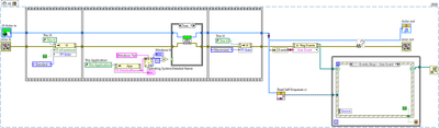

Thank you for downgrading! You're solution was extremely helpful!
My application uses the actor framework and I could not get the `FindWindow` command to return successfully.
I swapped that for the `GetForegroundWindow` command and I think everything works as my boss wants.
This solves my immediate problem, but @zou, I disagree. This is a labview bug. Notepad does not ship with this style for a reason, the developer(s) had a choice and decided "no, this style does not work with my software".
My application contains several popable UI subpanels and it seems this workaround is required on every UI vi in project, time for some inheritance.
