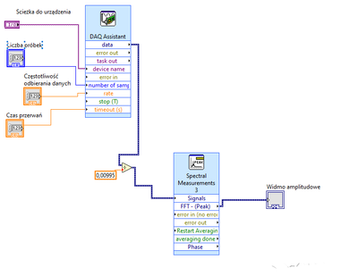

I need the Waveform Graph to extract the max value from the Y axis. I can read it from the chart, but apparently there is a function (max & min) that will directly display this max value to me.
I send a screen of the program and chart so that it is known what the maximum value I mean.
I count on help.
Yes, that is the function to use.  So what's your problem?
(3,523 Views)
I do not know how. I can't connect it correctly so that this value is visible
(3,511 Views)
Slight correction to what I stated before.  You actually want Array Max & Min.
(3,507 Views)
But I don't know how to combine it in the program
(3,500 Views)
The same way you wire anything else in LabVIEW.  Just draw a wire from the source of the data to the input of the Array Max and MIn function.  If coming from the DAQ Assistant, it will automatically drop a From DDT express VI onto the wire.
