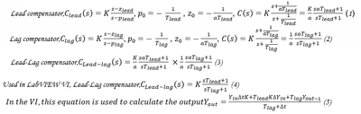

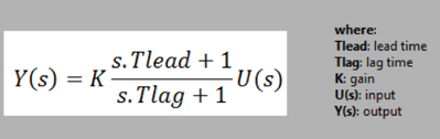

Could anyone help me to understand the mathematical background of PID Lead-Lag VI?
The equation mention in the VI

In the PID lead-lag VI Equation (4) is used as a transfer function and Equation (5) is used to calculate the output based on equation (4). Is there anyone please explain it? As per my understanding equation (4) will be like equation (3) for lead-lag compensation. However, they used equation (4) which  I did not understand. How does equation (5) come from Equation (4)?  Thanks in advance.

In general, without any control system knowledge, we can only verify if the equations are implemented appropriately in LabVIEW.
Beyond that why the control system equation is derived to such a state and how can only be explained by experts.
It looks like you did not develop all these and provided to you by your professor as part of some academic course, I would rather recommend you reaching out to your professor for an explanation on why it is such a case.
Please let us know if you need to know something in LabVIEW, any control-system related questions, this may not be the right forum.

Hi Santo,
Thank you so much for your nice suggestion. Actually, the Lead-Lag VI provided in the LabVIEW does not make sense to me. Maybe I am wrong because I am not a control engineering student. As per my understanding, the equation will be like equation (7) if I just transfer the s domain to the z domain.
Before using the VI I want to make sure everything is correct for the VI. Thank you again.
