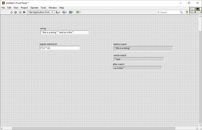

Is this what you were looking for?
(9,344 Views)
Interesting... I've tried using the expression you have here already, but with one small difference.
If I use a single set of quotation marks for the first string, the expression evaluates properly.
If it's a set of double quotes, the expression returns the string with a space between my quote and word.
I had assumed that the expression ["]+[^\s] would evaluate for all duplicated ["] characters before moving on to the 'any character but space' portion, but this doesn't appear to be the case; for the specified expression a set of double characters is meeting the requirements despite being followed by a space.
Is there any way to force the behavior I want, or will I have to parse for the quotation marks, and then check for a space in a separate match?
Using Labview 2022, Windows 10
(9,326 Views)

Try
 ["]+[[:alnum:]]+
This should match n lots of "
followed by n lots of alphanumeric characters which will stop when it hits the whitespace.
(9,313 Views)
Thank you!!
I was completely unfamiliar with POSIX Bracket Expressions so I didn't know this was something available to me.
This is what I needed!
