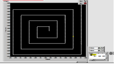

My Complete VI might be too big and irrelevant I am posting the whole loop here with another solution I am trying( which again does not work). So there are 4 loops in total. You can see 2 here. This code is used to do a Spiral scan out of a pair of 2 stepper motors and read optical power out which I would want as an array outside. Eventually I need to find the maximum power and its corresponding location in the Spiral Scan.

 thanks a lot for proposing to have a look at my complete VI. I was just scared people would call me out for putting a big VI up there. Happens in other tech forums where people just want you to ask your very specific question and leave. The LabVIEW community is different and that's awesome. So I am attaching my complete VI snippet here. I have attached a code snippet here. Though I don't think you will be able to open it as it uses .NET references to methods given by Thorlabs to operate their Motion Control equipment.
I have yet to make changes to the array data as given above. Pretty close to a solution but would really appreciate some general feedback on my VI as this is my first LabView project and my professor has no idea about the software.
 Okay so outside my loops I,m just enabling and disabling the motors. Inside the 4 while loops I am trying to trace a square spiral using 2 motors one for the X and other for the Y axis which looks something like this
with initial position (2,2) which then increments in steps of 0.001
the distance at which the angle changes( rather shifts from motor X to Y ) increases by 0.002mm. Something like this:
 Finally I'm graphing my output with a Build XY Graph.
I am controlling the program execution using the error line thus trying to avoid Race condition.
Thanks in advance.
