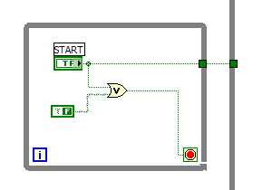

I have some question...1stly, I have created one program about my thesis. So, refer to my vi file that i post here. It have some mistakes in programming it.the mistakes are:
    1. the pause button didn't function after i put a local variable in a while loop. I don't know why. Of course that stop button did not work coz i dont have to wire it.
    2. Read measurement file. This program i have copy from the example. But something I don't like it because I want to combine this read file into one program within the other
        function.
    3. I'm using elapsed time to make sure this program will run from first time to the last time. This elapsed time using seconds to count it. How to convert this function from using
        seconds to day. Coz I want to key in with date/time format not a seconds.
Actually, there are more mistakes i think. But I think I want to fix this three 1st.Could anyone help me or give me some suggestions how to correct it. thank u very muchSmiley Happy

First of all, all your tight polling loops need small waits, else the VI uses 100% of the CPU doing absolutely nothing except checking the button millions of times per second. If you put a 10ms wait in these, the CPU use will drop to 0.01% without any change in behavior.
There is no logic in you boolean logic. That "OR FALSE" can be deleted without a change in functionality.
You should not have two different buttons labeled "start". That's confusing!
Your pause loop is set to "stop if true", meaning once you press pause, the loop only iterates once. Maybe you want to set the loop condition to "continue if true".
... I'll look at the rest later. I agree that the program should be rewritten from scratch. Too many odd constructs and duplicate code sections. 🙂

Thanks 4 ur reply.Yeah...you're right, seems like the pause button will function after we set the loop condition to "continue if true". How about the outputs of the array.I mean the output [DBL] indicator for V, I n P. how can I convert this values to scalar input.because I want put some numeric such as gauge, meter and etc. n I hope u will give me the solutions for the rest.thank u very much.Smiley Happy

Also note that your pause construct is way too complicated. You don't need the case structure. A single loop containing a small wait and the pause terminal (wired to the loop condition) is all you need.

Oh, I see.so, i do not need to put case structure in while loop instead a single loop containing a small wait and the pause terminal. thanks for ur suggestions. and my stop button.how can i wire it. In the main while loop i put the elapsed time and wired to the loop condition. So, I don't know how to wire it to make this stop button will function.thank u very much.Smiley Happy
