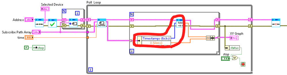

I am using a MFLI Lock-in amplifier to demodulate three times a specific signal previously modulated three times at different frequencies.
Zurich Instruments provide some blocks in order to manage all the device configurations and its control using labview. They also provides some examples in order to get familiar with the blocks, some of them are: 302_Module-DAQ_introduction_Continuous.vi, the ziExample-PollDemo.vi, ziExample-PollData.vi.
In the examples 302_Module-DAQ_introduction_Continuous.vi and the ziExample-PollDemo.vi the data of each demodulator is storaged and plotted after specific time (all the data of demod1, then all the data of demod2 and all the data of demod3 ). However, what we need is to take each point of data of the each demodulator at the same time ( data point 1 from dem1, data point 1 from dem2, data point 1 from dem3, data point 2 from dem1 data point 2 from dem2...) and plot each point of each demodulator when it is generated, not all of the data points at the end of an specific time.  In the ziExample-PollData.vi I am able to add more demodulator nodes but I am not able to separate the data taken from them. So please, could you help me to manage independently the data taken from the demodulators in the ziExample-PollData.vi? or help me to take the data from the 302_Module-DAQ_introduction_Continuous.vi or the ziExample-PollDemo.vi point by point, instead of all the points at the end and manage them?
Thank you in advance 🙂
I leave attached some pictures of the blocks diagrams.

The polled data from the demods and DAQ modules contains the timestamp or tick count. These counts are device-global. You subscribe to the data sources, poll them, then select the data belonging to a specific device tick.
Take a look at ziExample-PollDemod:
The circled area is where you can link up to your synchronization system.
