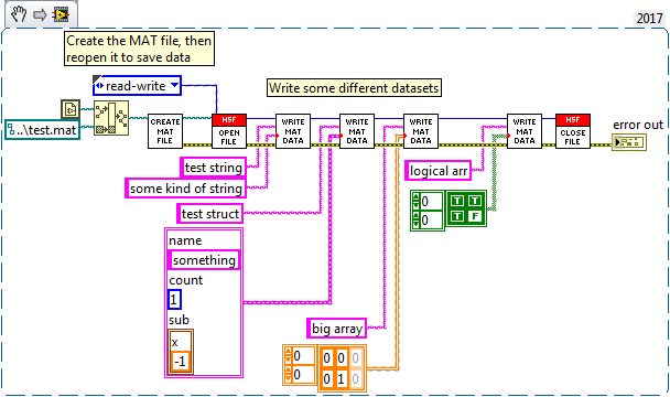

I have used HDFView to open a mat 7.3 file, so an HDF file with a MAT extension and a Matlab specific header.
See the example I referenced earlier, use VIPM to get the HDF library. I won't attach it becasue you need the HDF library I referenced earlier but below is a snippet and documentation.
"Version 7.3 of the file format uses HDF5 internally, so h5labview can be used to
read MAT files to load data from MATLAB directly into LabVIEW. This example
demonstrates how to use h5labview to build a MAT file for loading into MATLAB."
