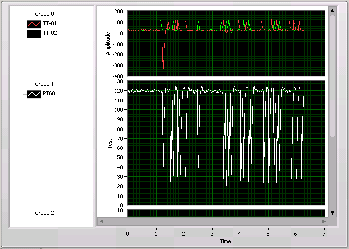

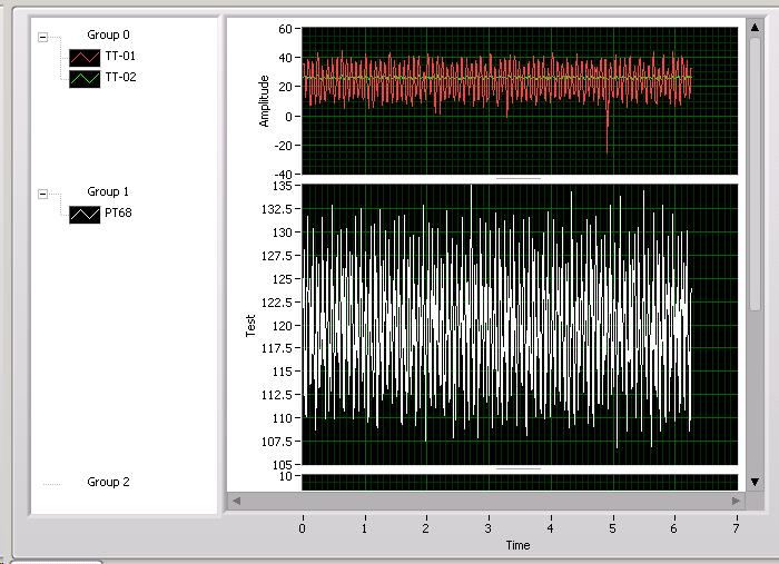

Lastly, here is the noisy data I'm dealing with:
Here is the data after I apply a 5Hz filter to each one:
Clearly data from one is being imposed on the other.  Hitting my "re-initialize" button to send a "true" signal through doesn't fix it.  How can I verify that my filters are working independently as desired?

I don't think this is related to ghosting or channel cross-talk.  If I apply my filter to just one of the signals, it looks fine.  The problem occures when I apply my filter to multiple channels.  I suspect that I'm not seperating the filter VI out into multiple threads properly and there is some memory "ghosting".

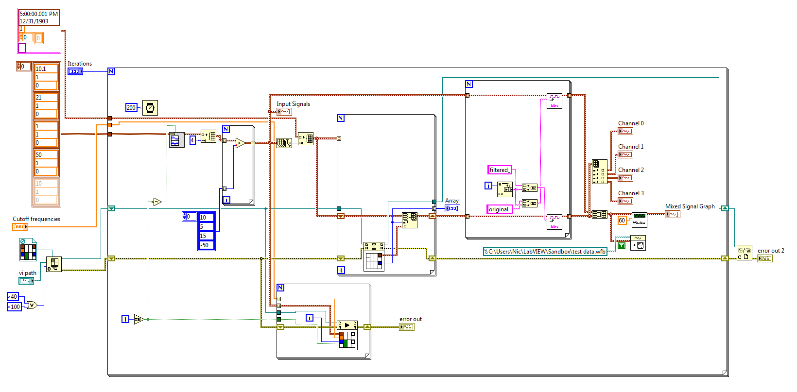

Hi Johnsold - I don't think the code you provided is working correctly.  I think it only appears to work, but it is coincidental because the input is the same regardless of which is filtered.  I'm not 100% sure about this.  What I've done is added an offset to each of the 4 input waveforms in your "Test multi-filter VI Server.vi", and my observations are consistent with what I'm receiving in my application with live data (from physical sources).
The results appear to be consistent with what I would describe as "memory scrambling" between the various calls to the filter.
Below is the modification I did to your code.  I've added different offsets to the data.  Then I've collected the data into a window for presentation on a plot.  The original signal appear just fine in my plot but the filtered appear to be suffering from "crosstalk".
