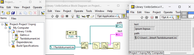

Here's what I ended up doing.
(620 Views)
I don't know if that's cleaner, since you're still assuming a relative path from your VI to the library in the express VI case, but I suppose it does minimize the chances of problems, since it's only for a single VI.
It assumes the relative path to the .lvlib file (which is not likely to change); but it does not assume anything about the location of the .ini file.

@Yamaeda wrote:
Why make it so advanced? KISS. 🙂
Because I want the .ini file in a different folder than the .VI.  And I might rearrange things later; but I don't want things to break if I do that.
