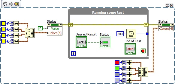

Here are the basics.  You will need to grow this to get what you want.Color Change.pngThe Desired Result Boolean within the loop is only to show that the Status color remains yellow until the test completes regardless of its state.

And backsaved to 2015 in anticipation of the request.
