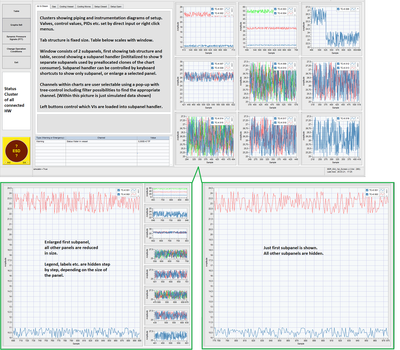

Dear all,
just for all who are interested. I sanitized the GUI a bit, this way I can show at least a bit the layout and how we solved the scalability of the GUI. Its just one of two screens but the second one is more or less of the same kind. The picture is scaled down, but GUI is build for FullHD screens.
We kept the tab structure fixed size, as we use fixed size clusters to display the P&I diagrams which are used to control the setup. The other elements ensure, that the GUI is scalable enough.
@mcduff: Thanks for the hint of reducing UI updates further more, if window is not shown. Simple and effective, and we've not thought of this yet. Thanks.
@richjoh: Yes we want to release a build and we're definitely interested in minimizing UI usage through compiler optimization. Finally to know how it works and decide not to use is always better than not using because of not knowing 😉
All the best.
David
