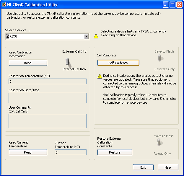

Jason,
Thanks for the reply. I have seen this error on different PXI systems so I think its not to do with LabVIEW installation as such.
One thing we did figure was that the RIO device was loosing its settings as shown below when the error happened!
The code SOMETIMES works after a restart or works EVERYTIME if We set the settings above, applied it AND ran the RIO self calibration.
I know it is a long shot but may be the self calibration resets/re-initialises references or something?
Any ideas?
