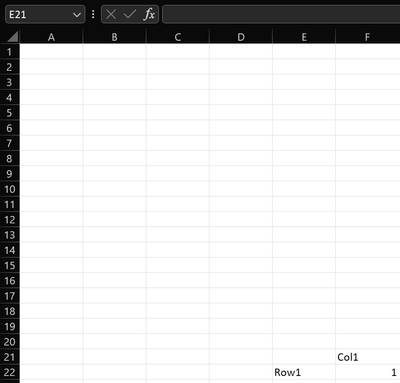

@SJE wrote:
Does anyone know how I should go about editing this VI to move 256 lines of data to the D column starting at row 20?
#1 open "..LabVIEW XXXX\examples\Connectivity\Excel\Excel - Write Table.vi"
#2 define offsets
#3 run .vi, observe excel
this will open a new .xlsx file, creating a 2d table at the offset defined. you will need to define proper limits for the offsets...
the number of rows of the pink 2d array defines the number of rows written via auto-indexing.
as this is creating a new .xlsx file you still need to figure out how to open an existing file, and getting the offset right each time, to properly append new rows....
