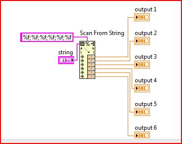

Receiving these strings through TCP connection is working just fine, however I just noticed that after passing a string such as my example into a 'Scan String for Tokens' block, the negative signs are dropped from the latter three values. I assumed it has something with setting '-' as an operator, but simply wiring negative sign in as an operator didn't change anything. I know there has to be a way to retain my negative signs, but I can't figure it.

Is this what you need?

Yes! Thank you very much!
Your example brings up another question, though. When you pass those values into an array, is it possible then to pass individual array elements back out?
(4,678 Views)
if you're always sure that there are six elements in the array, you could use index array. Alternatively, instead of using the above function, use scan from string.
