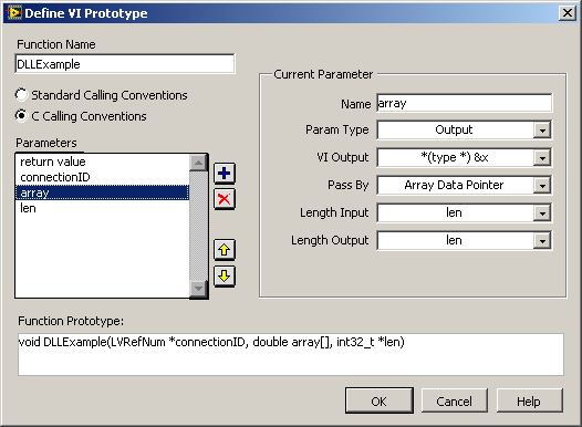

Thank you so much for your response. I 've committed so much time on this that I am more willing to use labview dlls. I am wondering if you have any suggestions as to what to change on the read. vi (my read vi is on my previous post) so that I can convert it into dll and read it in the vc++ environment. I did this successfully for a double number. In this application, my server sends a double number, and I read this number with Labview read.dll on the vc++ side just fine. Now, I am trying to do the same with an array.  I would really appreciate if you could let me know how to do this.

Whe creating the DLL, define for the function parameter to be an Array Data Pointer instead of an Array Data Handle. Now the DLL will accept a simple double *arr parameter as any C compiler can handle it. Allocate the array in the caller to the correct size and also pass in the size to which it is allocated.

I really really appreciate your answers! I have one more question (hopefully last). When creating the dll, I defined the function parameter as Array Data Pointer as you suggested. I also made some modification as shown in the picture attached. Now I am using the following simple c++ code to read the output. However, I can't see anything on the screen. Do you have any idea why? Again, thank you so much!!
Kind Regards
int main(int argc, char* argv[])
      uInt32 a;
          double MyArray[8];      //Initialization of array
 a=Init();      //Initialization of THE PORT
 int i=0;
  while (i<1000)
 Read(a,MyArray,8); //READING THE OUTPUT OF READ.DLL
          std::cout << "The result is" << MyArray[2] << '\n'; \\PRINTING ONE MEMBER ON THE SCREEN
          i=i+1;
Close(a);  //close the port
   return(1);
