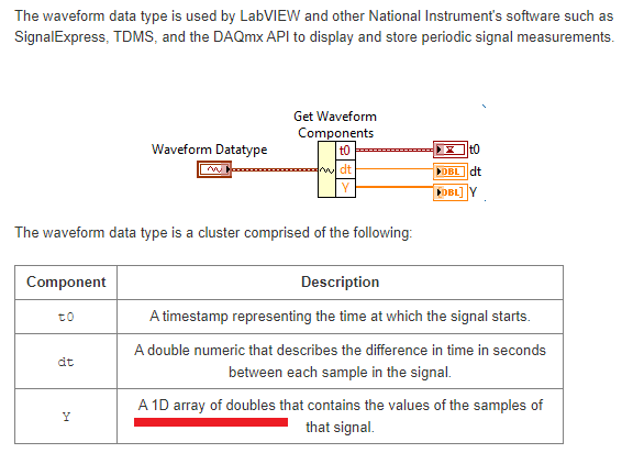

Obviously, you know more than me here, but I always thought that the Y component of a waveform is always a 1D array. (We are not talking about dynamic data, right?)

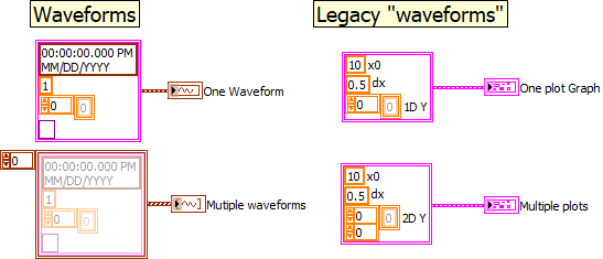

Compare that to the legacy, pre-waveform [xo, dx, [Y]] cluster that can have 1D or 2D arrays for Y:
So how exactly are you defining a single waveform with N channels without using an array of waveforms?

My intention was to be lexically nit-picky.  A waveform necessarily occupies at least 2 dimensions.  There's no such thing as a "1D Waveform".
