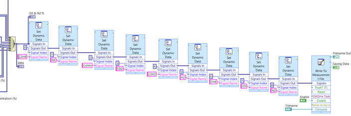

I will also need to export and save these values into an excel file. When I was using the usb-6008 daq module and daq assistant function, I was able to split the signals and export to excel like this:
It does not seem like this will work for the array values. What is the recommended way to do this?
I've attached my updated vi. If you open it, you can ignore the graphs that are not connected right now.
Simple programming rule (not just for LabVIEW): whenever you need to repeat an operation you should use a loop!
Why don't you use a loop (with a shift register) to set the signal properties???
But:
  • Why don't you define the signals "correctly" for your DAQmx task? That's the place where you define the signal name! No need to do this again and again when trying to save data to a file!
  • Again: get rid of all those ExpressVIs and DDT wires! Use the waveforms provided by DAQmxRead!
