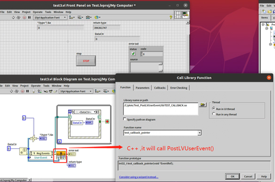

I wrapped the PostLVUserEvent function in C++/C and I called it in Labview.

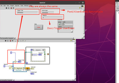

Executing it in the development environment did not trigger the user registration event, but it did trigger the user registration event in the runtime environment.
Let me show you some pictures:

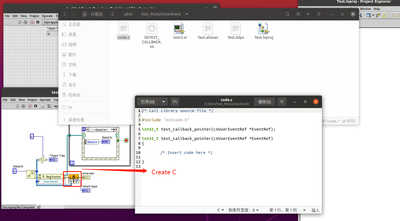

3) When passing the user event refnum to the C function LabVIEW passes it by reference. It is more easily to see that if you use explicit datatypes. Right Clicking on the CLN and selecting "Create C code" will actually generate this prototype (on Windows at least):
#include "extcode.h"
int32_t funcName(LVUserEventRef *refnum);
    uint64_t value = 12345678;
    return PostLVUserEvent(*refnum, &value);
Filling in the body as here will be all that is needed to pass the number back;
4) In the C code you pass the return value of PostLVUserEvent() to the caller as return value. This is a MgErr (int32_t), but in the example you show it is the numeric value of the user event refnum! How can that be? Either your C code you attached is not what you are really executing or the panel values you show are not from a proper execution. If it really is as you say, something somewhere seriously is messing up your stack. Are you sure you compile the code for the right calling convention? (I don't believe there is any option to select calling convention in the Call Library Node under Linux as LabVIEW 64-bit for Linux only supports the standard first 6 parameter in registers and then the rest of the parameters on the stack).
The weird thing is that even if the function somehow would not be called correctly, the first parameter (the reference to the refnum) would be passed in EDI (but not the refnum itself) but the return value is retrieved from EAX (which should be the return value of the PostLVUserEvent() call).

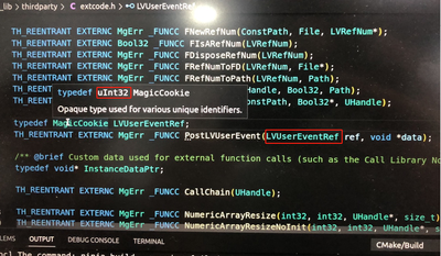

1. I looked up the prototype of the PostLVUserEvent function, which defines the user event as uint_32, so my wrapper defines the uint_32 parameter.

3.  See picture
4.This is where I feel the same pain, but from the C code it looks like the test_callback_pointer function simply calls PostLVUserEvent and passes the input user event and the defined character constant to PostLVUserEvent; Compiled shared libraries also follow the C protocol.
In addition, I generated the application with Labview vi, and Labview was able to respond to user events normally.

Strictly it defines the first parameter as LVUserEventRef. Yes that eventually is an alias for MagicCookie and that is again an alias for an uint32_t but in these cases I prefer to keep the most distinctive datatype definition, eventhough it won't matter for the compiler. But for any casual reader of the source code it can make a whole lot of difference.
