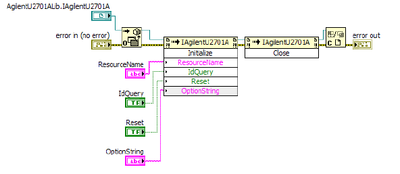

They suggest this diagram instead of using Constructor node
With the same .NET selection thay you did above, but instead of Constructor Node, you configure it on an "Automation Refnum terminal"

hi LFBaute,
I refer to your suggestion, but "ERROR -2147221164" appears during execution, what should I do?
