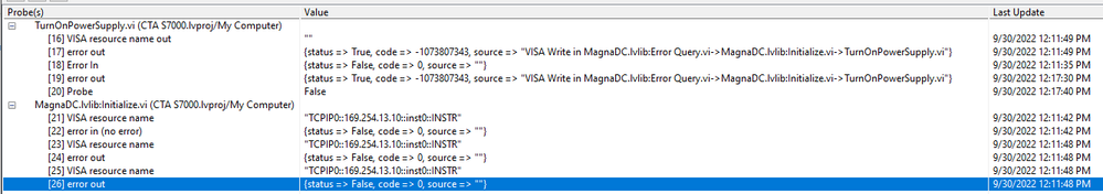

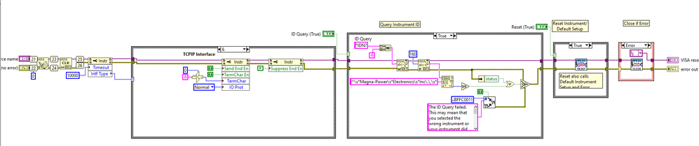

In labview 2021 version, the driver associated vi called Initialization.vi is not playing well and generating an error as its output. The error does occur when it hits visa related objects inside the initalization.vi. For example, attached is an example of how it errors out for MagnaDC powersupply. Initially it was assumed that it was only magnadc driver related but the same error seems to be reciprocating for other component drivers as well and in the same instance when it hits the visa related object in the vi.
MagnaDC initialization.vi:
Initialization.vi with Probes:
Error after being run:
Probe window after being run:

Judging by the error message (that I had to look up because you didn't bother posting it)
"Insufficient location information or the device or resource is not present in the system"
Either the device is not on the IP address or the Initialize vi is looking for a serial port.
I can't tell by your pictures it you have the initialize vi wired properly. Which is why you should always attach your vi not just insert pictures of your block diagram.

In the case of the magna driver error, your problem is most likely the visa string you're using. You gotta replace "inst0::INSTR" with "50505::SOCKET" (magna's default TCP port is 50505). At least this is how it is with the TS series, which I'm guessing is common across all of their power supplies. Best way to get the correct VISA string is to open a web browser and go to the instrument's IP address. On the information page it'll tell you what the instrument address string is.
