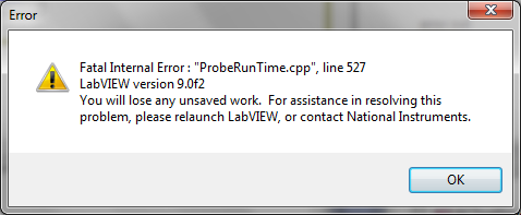

I've been experiencing a lot of crashes when probing wires in Labview 2009 f2.  Usually it happens when I probe an object wire (no custom class probe), thought it has happened when I probed a global also.  It's gotten to the point where 2009 is almost unusable--I'm afraid to probe anything.
The error is always the same.  Has anyone else run into this problem?

Right now the crash seems to be related to particular classes.  (The other day I was seeing crashes when I probed a specific global, but I no longer have that code available to test.)  I have at least two classes (an abstract parent and a concrete child) that will cause Labview to crash whenever I probe their wires in any vi.  There are other classes in different class hierarchies that I can probe.
Recompiling didn't help.

There is a known issue associated with probing LabVIEW OOP wires with IMAQ controls in them.  Do the problem wires contain anything related to IMAQ or VIsion?

Nope.  The child class does make some calls into a .Net assembly that wraps a generic usb driver dll, but no IMAQ or Vision.

The solution for the IMAQ issue is to either use indicator instead of probes, or to avoid including IMAQ VI's in OOP classes.  Since you are not using IMAQ, we do not have any recorded issues.  Could you post your crash log and the associated files that are causing the crash.  I would like to reproduce your issue here, so I can report it to R&D.
