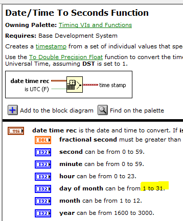

By the way, Chris, adding thirty to the "day of month" field is a good trick.  But I can't really find where in the LabVIEW help it's stated that the Date/Time to Seconds node will properly promote a record with a "day of month" field out of range (though it nags at me that this is defined somewhere, and it clearly works...)  Do you know where it might be documented?
The standard help really makes it look like the behavior is just unspecified...
I wasn't sure and just tried and it worked. No guarantees. Most likely it just adds up the seconds for each field.
(Similarly, if you e.g. enter February 31 into a timestamp control, it will instantly normalize it for early March. :D)
