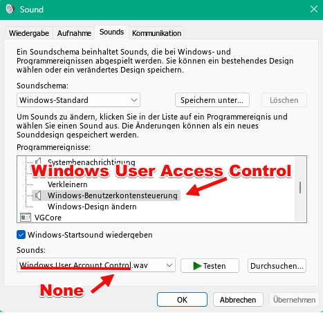

One most crazy suggestion I ever made — try to turn off sound playing when UAC Window is appeared. But sorry, I have the only German screenshots. On the affected PC:
1. Hit Win Button, then type "Sounds":
Then navigate to UAC and set sound to None:
Technically your application is not signed (supposed to be not), then on the first run on Win10 PC the UAC Window should appear:
At this time Windows tries to play sound according the settings, but unable to do this (some troubles with audio setup, drivers, etc), then error message appeared.
Refer to the article Windows 10 The extended attributes are inconsistent.
The proposed solution:
1.Right click on the sound icon beside date and time on taskbar
2.Click Sounds
3.In the Program Events find 'Windows User Access Control'. Click on it.
4.Below that you will see 'Sounds'. Click on the drop down menu of 'Sounds', and select 'none'
5.Click 'OK'
If this not help, it could be something different, I would to recommend to open Event Viewer and check Application log — something shall be entered here, which might be helpful for troubleshooting.
