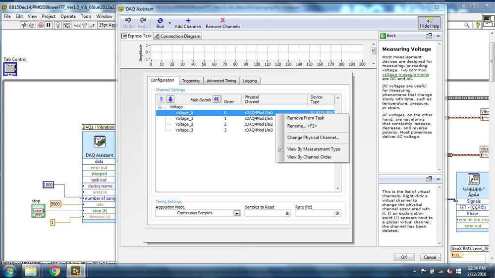

We have a vi that runs to collect data using a NI 9215, we took that vi and converted it to an exe using application builder. When we deploy the exe on a laptop and connect the cDAQ-9171, the vi runs fine and collects the data. The problem comes when we switch the cDAQ to a new one, the NI device is looking for the last one that was installed and will not run the vi. We would have to go into DAQmx, delete the old device and refresh it, then run the vi and it works fine.
Is there a way we can modify the vi to automatically choose any CDAQ module instead of looking for cDAQ1 or cDAQ2....etc. Is it possible or is there more to this that i'm not seeing. We need to make it easier for technicians to not have to do alot of configuration of the computer as sometimes they are not proficient in that sense.

So this would display the device, but the user would still have to configure NI Device Monitor to look at the current device correct? I'm looking to see if there is anyway to have the vi auto select the active device or at minimum be able to select which device to use without going into the block diagram?
the only way I know to do it right now is to go into block diagram and physically change the channel.

Ok, I see that you're using DAQ Assistant. In this case you can programmatically tell it which device to use with the "device name" terminal:

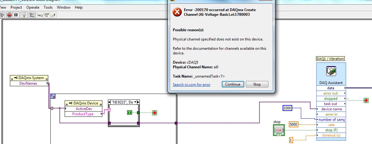

I am using 2014. So I did figure out the case structure, and I thank you for your explanation. I was able to re-create it but when I run it I get an error. Note I am only using channel 0 on the 9215.

Specifying Default in the case structure means that case will execute for any input that doesn't already have a separately defined case. Your "NI 9215" case also includes the Default in the same case. So if the first item in the device array is your chassis (cDAQ5), the code in the "NI 9215", Default case will still execute because there is no other defined case for "cDAQ5". This means the loop will stop and the "cDAQ5" device name will be sent to the output of the loop, which causes the error you are seeing because the DAQ assistant needs the entire name of the module. Your case structure needs to have two cases: one for "NI 9215" and one Default case to handle everything else that isn't a 9215:
Also, by putting the property nodes and For loop inside your While loop as you've done, you're telling it to execute that code repeatedly, when you really only need to get the name of the device once. Put these items outside the while loop and only wire the device name into the loop, as I've done in my example.
See the attached VI.
