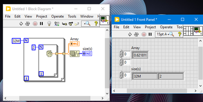

I tried an experiment.  You are sampling 2 channels of dbls and say " To store this information will require (32MSa)(8 Bytes/Sa) = 256MB."  My first question is I assume 2 channels of Dbls take 2 * 8 = 16 byte, so you would require 512 MB, if I understand your situation.
I wrote a little demo routine to generate a big 2D Dbl array.
This generates 30 M samples which requires 480 MB, and there is no problem with exceeding memory.  Pushing it to 32 M, however, does "run out of memory".

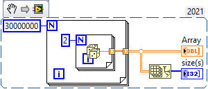

I was able to generate a 32M x 2 array of DBL without any error. So, in short your claim that LV can't handle has been disproved.
@mcduff hit the point, it is not about whether LV can handle that data, it is whether the way you handle the data is inefficient that you run of memory.
In fact, I easily generated a 100M x 2 DBL array like breeze.
Edit:
I successfully created a 500M x 2 DBL array on LV 2021 64-bit on a Win 10 64-bit with 32GB RAM Laptop
