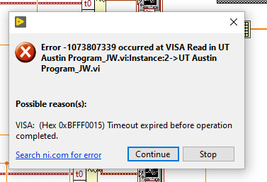

I am completely new to LabVIEW and need help here.
I am trying to use LabVIEW to record the pressure reading on a Honeywell read-out box with its one end connected to the transducer and the other end connected to the computer (LabVIEW). The part number of the Honeywell read-out box is 060-1833-18. Both the transducer and the read-out box are working fine and they are showing correct reading. However, the LabVIEW software shows up error code: 1073807339 (Time out error). I know that this type of error shows up when there is no data flowing into the computer but I could not figure out why. All the cables are correctly wired so I think that the problem is in the software itself. The software also highlight the Honeywell read-out box part on the block diagram to show where the error is.
I am attaching my error message screenshot and my block diagram. The red circle is where the Honeywell read-out box part is and it is where the error message highlights.

Your message makes no sense. First off the part number you give (060-1833-18) is for a transducer, not a "read-out box", secondly I only see analog options for that transducer and the image of LabVIEW code (not actual code) you posted looks like you are trying to read serial data.
I Googled "SC500" and I found a page that refers to a Honeywell signal conditioner. I am guessing that is what you are calling a "read-out box?" In any case the only information on any kind of digital communication I could find there is something called Honeywell's Signature Calibration. Even if you could read that with a serial port (which I doubt you can) that information only contains calibration data and doesn't have the signal, IE pressure in it. Just the instructions on how to interpret the analog signal.

Well you have verified that you can communicate with the Honeywell so next step would be to debug software. I recommend getting rid of the instrument assist VI's. They are not that great and are probably opening and closing that port unnecessarily. Use VISA configure port (and change the termination character to 13) and the VISA functions. This way you are opening the port once, and closing the port once. I would do this for both serial devices.

Okay I was able to make the time-out error disappear and push the run button but instead of showing the reading of the Honeywell read-out box it just shows a constant number of 11.
