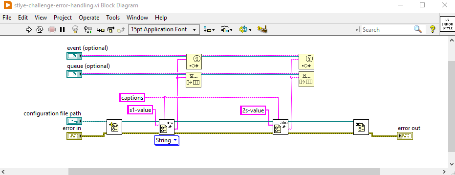

Had this tab queued up half the day before getting back to it.  Now that I've gone back and looked at some other posts, it appears to me that Hooovahh posted code that's functionally identical to mine but far less ugly.  I'd also give him the nod for wrapping everything up in an error case structure.  The post from Gregory is *almost* the same and looks even neater, but it differs just a bit in error precedence.
Interesting little topic.  Here's my contribution with a few additional comments below:
Additional comments:
5. Ouch, pretty ugly aesthetically!  Look at all those wires!  But functionally, I really don't want to remove any.  I've got specific reasons to want all of them.
6. General principle: upstream errors propagate to nullify *relevant* downstream actions, but not necessarily *all* downstream actions.  So an error reading the 1st value does not propagate to prevent an attempt to read the 2nd.  But an error reading either *does* propagate to prevent signaling that particular one via queue or event.
7. General principle: all error outs get collected and merged, with careful attention to sequence / precedence of errors.  (This is my starting point in real-life code too.  By default, all subvi "error outs" are accounted for in this vi's "error out" -- unless I make an explicit decision that specific ones can or should be ignored.)
8. General principle: leave supplied code pretty much in-place.  Make no additions unless necessary (such as Merge Errors).
-Kevin P
Message 24 of 147

Kevin,
That is darn sneaky depending on the dataflow of the file refnum to enforce execution order of the enqueue and generate user event operations.   I had to look 3 times to see it.
"Should be" isn't "Is" -Jay

Jay,
Confession: it wasn't meant to be a clever trick, it just sorta happened when I mentally "unrolled" the implied loop of "read-send-send / read-send-send".
Overall, I liked the approaches that repackaged this stuff into an actual loop, but none of them did the error propagation / precedence in quite the same way that I would want.  Here's how error propagation would look in *my* loop version:
-Kevin P

@Kevin_Price wrote:
Jay,
-Kevin P
Overall, I would make the following changes to Kevin's code, If I didn't reject the silly construction for reasons previously stated.
  • Place the Error wire into the loop on a SR (to propagate upstream errors if Key[] is empty
  • Place the config file refnum on a SR for the same reason.
  • Branch the Error wire into the loop into three paths immediately at the Left SR inside node.
  • Merge all three errors with a report all errors option
  • Terminate the loop on Merged Errors = TRUE
  • WIRE the Error SR out from the loop directly to Close Configuration File.
  • Remove the case structure it's redundant for all Error consumers in this vi EXCEPT for close configuration file which will attempt to close the file anyway and report the upstream error if one existed. By internally passing a No Error into the File Close and merging errors (report first error option.)
And yes, if you merge copies of the same error ( reporting all errors) you only get one instance of the error because <Status,Code,Source> is found already and not added to the output again.
