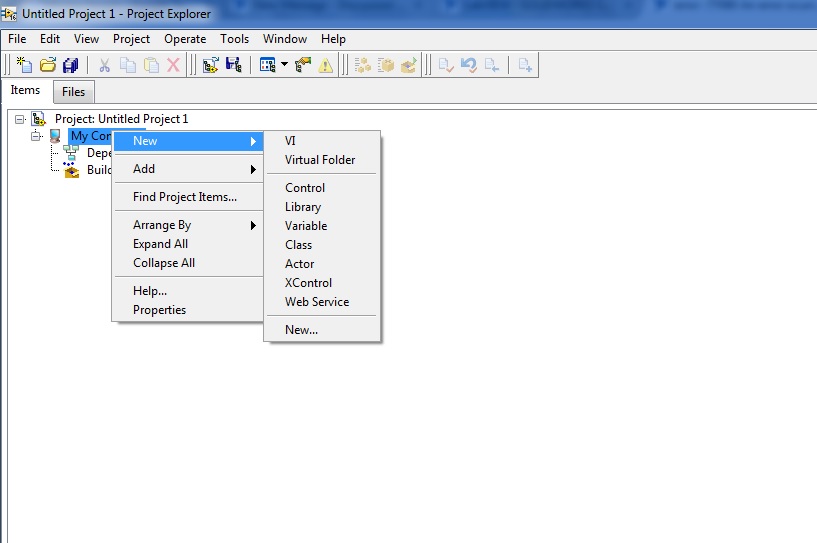

I am a new lab view user, i am trying to connect lab view with solidworks to simulate and control in my assembly. after installing labview 2016 64bit, and installed also soft motion module (LabVIEWSoftMotionModule2016f1) and activated it in lab view but i don't see the softmotion appear in lab view window when i am starting new project neither my assembly. this what i see every time. how i can solve this problem.

Is there a reason you are using LabVIEW 64 bit?
According to https://www.ni.com/en/support/documentation/compatibility/09/national-instruments-product-compatibil... it doesn't look like Softmotion is available for 64 bit LabVIEW.

As i have win7 -64

You can still install LabVIEW 32 bit on a 64 bit OS, just like most applications you have installed on your PC are probably actually 32 bit.
The only reason to use 64 bit LabVIEW is if you have some need for very large data spaces and don't have requirements for any toolkits that only exist for 32 bit LabVIEW.

FYI, LV 32-bit and 64-bit can live side by side with no issues.  Just remember that when you install LV 32-bit, you will have to reinstall your drivers and toolkits so LV 32-bit becomes aware of them.

After installing LV 32bit beside LB 64bit version, i noticed that soft motion automatically added and it works well right now. thanks so much Guys for your kindly help.
