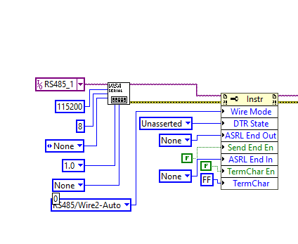

My RS485 port is configured as shown in below excerpt of block diagram:

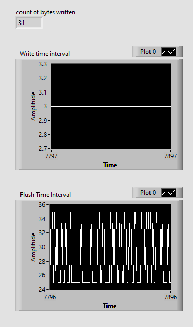

I was surprised when I found out that the flush function would often take up to 40 ms to complete.  I would not be able to send data at 100 Hz if the flush command would take this long.  Here's a screen shot showing my chart of measured times for write vs flush functions.
So after some searching, I found a NI article that reducing the serial buffer sizes might improve real time performance. Using NI MAX I saw that the initial TX buffer size was 128 bytes.,  I used NI MAX to reduce the TX buffer size for the RS485 port I was transmitting on.   I kept cutting the TX buffer size in half until I saw some improvement.  I was finally able to reduce the flush time by changing the TX buffer size to 2 bytes, but in this case the serial write time increased to 5 or 6 ms.   So there was a tradeoff, but this at least let me transmit my command at a fast rate.
Here's a new screen shot showing my chart of measured times for write vs flush functions.
My question is why does the flush command takes so long with the larger buffer size?  It doesn't seem like it should take this long. I wonder if there's some other RS485 setting I may want to make?

Flush is not doing what you think it does. It does not force data to be send out any faster or through special means. It is mainly to guarantee that all the data currently in the buffer is send out before you do something else.
So it is much more like a "Wait until the buffer is empty" than anything like, "Push this data out even faster than you ever could otherwise!"
The VISA Write will transfer the bytes to a buffer and then VISA at the earliest possible time will transfer it to the OS, which again will put it in some buffer and then feed it to the serial port FIFO independent of you using Flush or not.
Basically Flush simply does all kind of checks, querying the OS for status of its own buffers and what else until everybody down the line reports: Nope, there is no data to transfer anymore. Then Flush returns to the caller.
It does not speed up the writing of the data significantly at all but has extra overhead to do all these kind of checks.
I'm not sure what your Short Test Cmd contains, but it seems to take at least 25ms at 115kBaud to transmit. 😁 So that would be something like 250 bytes?
Basically your assumption about what Flush does is wrong and your debugging of the process is accordingly useless as it was based on bad assumptions. Also your Flatten function is totally useless. A Byte Array to String function does the same but without any extra overhead as it is basically nothing more than a typecast.
If you want to write data as fast as possible, you should write the data as fast as possible and not try to add artificial synchronization barriers that only can slow down things.
That all said I wonder if your serial device is really expecting to get thrown a never ending stream of bytes at it. Usually serial protocols work on a command response model but that of course adds exactly more of above mentioned synchronization barriers into the mix.
