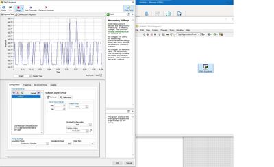

Hello All,
Even after successfully configuring the DAQ Assistant, none of the terminals to connect inputs or outputs shows up.
Note that I already tried the following but none of the solution worked.
https://knowledge.ni.com/KnowledgeArticleDetails?id=kA00Z0000019UDMSA2&l=en-US
- Repaired the DAQmax and confirmed that the Labview18.0.1 and DAQmx Driver 20.1 are compatible
Please let me know if anyone has any other suggestion for me to try out.

Thank you for the response and proposing an alternate solution of using NI-DAQmx instead.
However, I am still wondering why my DAQ Assistant is missing terminals even after configuring the exact same way as I created the task.
I also confirmed that I am able to open NI-MAX and use Test Panel to read the signals.
Please let me know what I need to do to make the DAQ Assistant to show up the terminals. Is it that LabView is missing some privilege to update the DAQ Assist Express after the configuration is set?

I already tried the solution in the link below and ensure that the Lan
I also tried re-installing the NI-DAQmx but the issue is still unresolved.
Please note that the Block Added before indicates the terminal correctly but the new ones do not.
Please refer the picture attached.

Hello Reza.
Yes, I did try the suggestion from Bob. Please see my response to it on ‎07-10-2020 10:42 AM
I tried to reinstall the DAQmx but still the issue is unresolved.
