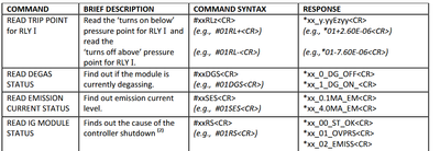

I'm new to this place and I'm learning amazing things about Labview. I'm trying to control my Ion Gauge from Kurt J lesker with labview but it seems imposible. I watched al the VISA posts, contents, forums etc. And I'm not able to get any pressure lectures from the device.
I'm working in a lab and we need to get the pressures, I'm going to leave you some pics with the problems that I'd found because I was only able to start the IG ON and OFF... It seems that it's not able to read the pressures...
(I tried with some visa property nodes, other configurations... and nothing). I'm using a RS485 converter and the KJLC's PS501-A power supply so I only plugged the pin 6 of my KJ lesker 354 (RS-485 DATA A -) to T/R-, the pin 9 (RS-485 DATA B -) to T/R+, and the GND to GND. I'll leave you a manual user guide too 🙂 Thanks and I'm using a DTECH USB 2.0 to RS422/RS485 wire.

Did you set up the serial communications in LabVIEW to the specifications in the manual?
If so can you attach your code in LabVIEW version 2020 or older so we can better support you question?

Ensure LabVIEW recognizes the DTECH USB 2.0 to RS422/RS485 wire as a Visa device .
Check the Speed and configuration as suggested.
Before going into LabVIEW, use NI Visa Interactive controll to send commands to the device and see that it responds back. Once you tested that the communication is working, then try running the example from LabVIEW.

It times out because is waiting to read 1024 bytes. The device is responding 13.
Message 7 of 11
(1,247 Views)
It also says that you need a CR.

OMG it was a problem of the DTECH. For everyone who wants to try with other solution for the KJ lesker 354 this is better https://www.digikey.com/en/products/detail/display-visions/EA-9790-USB485/22119716?gad_source=1&gad_...
